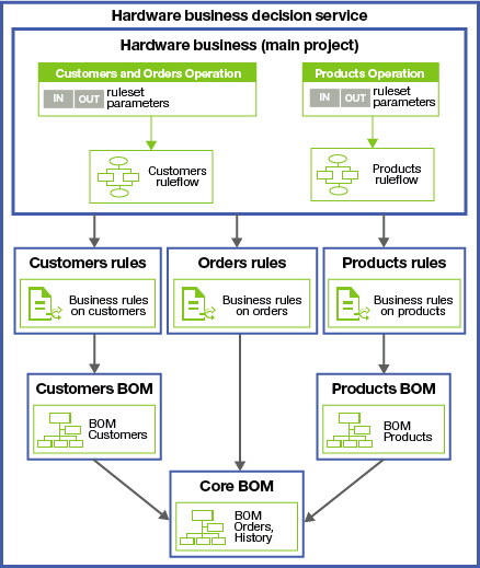

Organizing the project structure for multiple rulesets
If the client application calls different decision points, you should organize your project structure for multiple rulesets.
If an operation and its rules require only part of a BOM, you can keep those rules and that part of the BOM in a separate rule project hierarchy that specifies the vocabulary that is available to those rules. The size of the BOM can result in usability and performance issues. To reduce the number of completion entries in the rule editors, and to make them more relevant to your rules, use categories to organize your vocabulary into subsets.
With decision services
You can package all decision operations, ruleflows, and rules in the same decision service. The following diagram shows a decision service that is designed to distribute the decision points in separate rule projects. It also shows a strategy for splitting the BOM for efficiency.
Diagram shows project that share a BOM.
