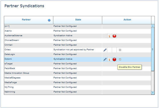

  4. Disabling a Partner If you no longer want to syndicate data to a partner, you can disable that partner. Navigate to the Partner Syndications page in the AdTarget Manage tab and click Disable this Partner.
    Disabling a Partner Syndication
    As soon as you have disabled a partner, you will notice that the Partner Syndications page will update with a new State shown for the selected partner. You can navigate back to the Integrate tab in AdTarget to see that the partner's status has changed from Active (in production) to Syndication disabled.

    If any unexpected site behavior is noticed and you believe it might be attributable to AdTarget data syndication with your selected partner, disable syndication by reverting back to Active-Test mode. A button is provided on the Manage tab > Partner Syndications page that will allow you to disable Active syndication with a partner.
