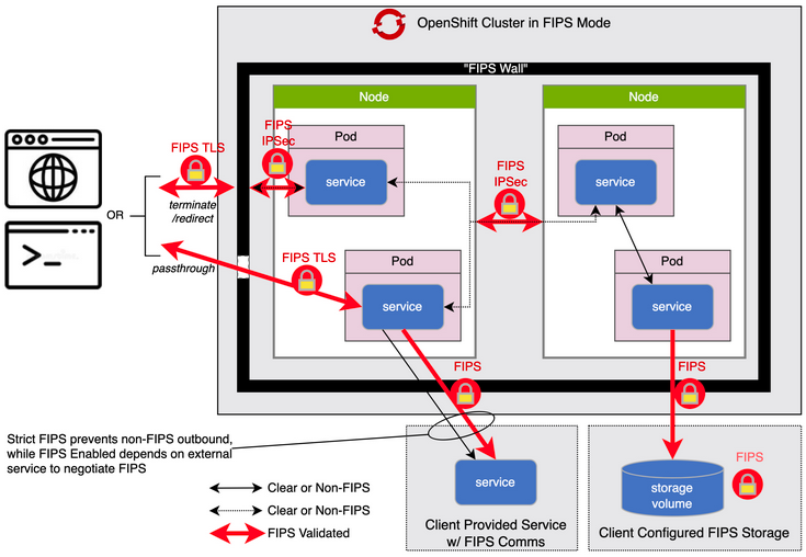

- What is a FIPS wall?
- The "FIPS wall" is a boundary approach to FIPS compliance that is used by IBM products. All pods
in the cluster are FIPS-tolerant (the pods can run without issues on a FIPS-enabled OpenShift
cluster), while creating a compliant "boundary" that is secured at external points of contact (known
as "touch points").
Traffic inside the boundary is secure because the communication between nodes is automatically encrypted at the OpenShift Container Platform level using the IPSec protocol. Traffic within any node happens in-memory, so it never leaves the node. The following diagram illustrates a typical OpenShift cluster that is configured to support the FIPS wall. In the diagram, the "wall" is represented with a heavy black border. Communications between pods within the border are secured with IPSec encryption, and communications that cross the border to external devices are secured using other means for example, TLS encryption).
