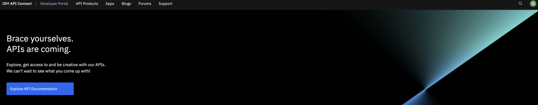

The front page Main navigation displays like this before the changes are made. A screenshot of the original front page
