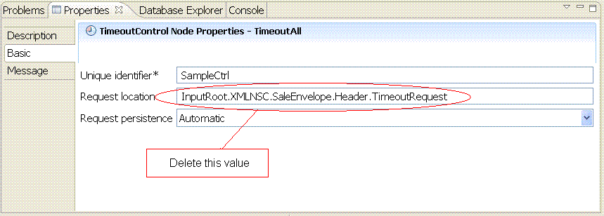

Do not forget to set your Compute node to Pass Message and LocalEnvironment. You must then change your TimeoutControl node to have a blank Request Location, if it has been changed from the default value:
