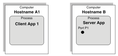

A TCP/IP connection between two applications has a client end and a server end, which means that one application acts as a server and the other as a client. The terms client and server refer only to the mechanism used to establish a connection; they do not refer to the pattern of data exchange. When the connection has been established, both client and server can perform the same operations and can both send and receive data. The following diagram illustrates the locations of client and server applications:
Diagram showing the locations of the client and server applications.

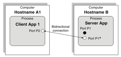

  1. The server application listens on a local port (on the computer that is running the application) for requests for connections to be made by a client application.
  2. The client application requests a connection from the server port, which the server then accepts.
  3. When the server accepts the request, a port is created on the client computer and is connected to the server port.
  4. A socket is created on both ends of the connection, and the details of the connection are encapsulated by the socket.
  5. The server port remains available to listen for further connection requests:
    Diagram showing the connection between the client and server applications.

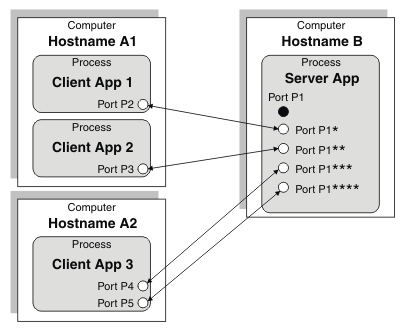

The server can accept more connections from other client applications. These connections can be in the same process, in a different process on the same computer, or on a different computer:
Diagram showing multiple connections between the server application and three client applications.
Only one server application can exist, but any number of different client processes can connect to the server application. Any of these applications (client or server) can be multithreaded, which enables them to use multiple connections.
