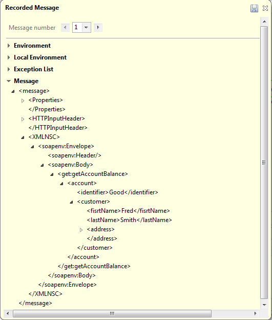

- Click a highlighted connection to view the data that passed
through the connection.
A
Recorded
Message dialog is displayed that shows the logical
message tree for each occasion that a message passed through
the connection, as shown in the following image.
If the message is too large
for the Recorded Message dialog, only part of the message
is displayed. To view the complete contents of the message, you can
right-click within the message in the Recorded
Message dialog, select Copy unformatted
message from the menu, and paste the message
into a text editor.
If more than one message was sent to the
message flow, or if a single message passed through a
connection multiple times, you can see the state of the
logical message tree for each message instance by selecting or clicking
through the message numbers in the dialog header.
