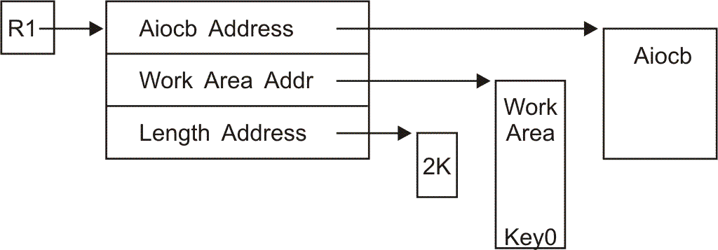

Aio#Posix. - AioExitPtr
- Specifies the address of a program that the system is to call when the I/O completes. The Aiocb from the original request is passed to the exit. See 4 for details. In 64-bit mode, AioExitPtr is a doubleword pointer field, and is at a different offset within the Aiocb.
- AioExitData
- An eight-byte area that is reserved for use by the application and the exit program. The system does not inspect or change this area.

- The exit program receives control in the asyncio caller's address space and in the following
environment:
Operation Environment Authorization: Same as the caller of asyncio Dispatchable unit mode: SRB or TCB Cross memory mode: PASN = HASN AMODE: Same as the caller of asyncio ASC mode: Primary mode Interrupt status: Enabled for interrupts Locks: Unlocked Control parameters: All parameters are addressable in the primary address space in key 0 storage. On entry, register 1 points to a parameter list that contains:- The address of the Aiocb that was specified on the asyncio call now completing
- The address of a 2K work area for the exit's use
- The address of the length of the work area
For authorized exits on the SRB, the work area is in key 0. For unauthorized exits, or authorized exits running on the TCB, it is in the key of the caller of asyncio.
