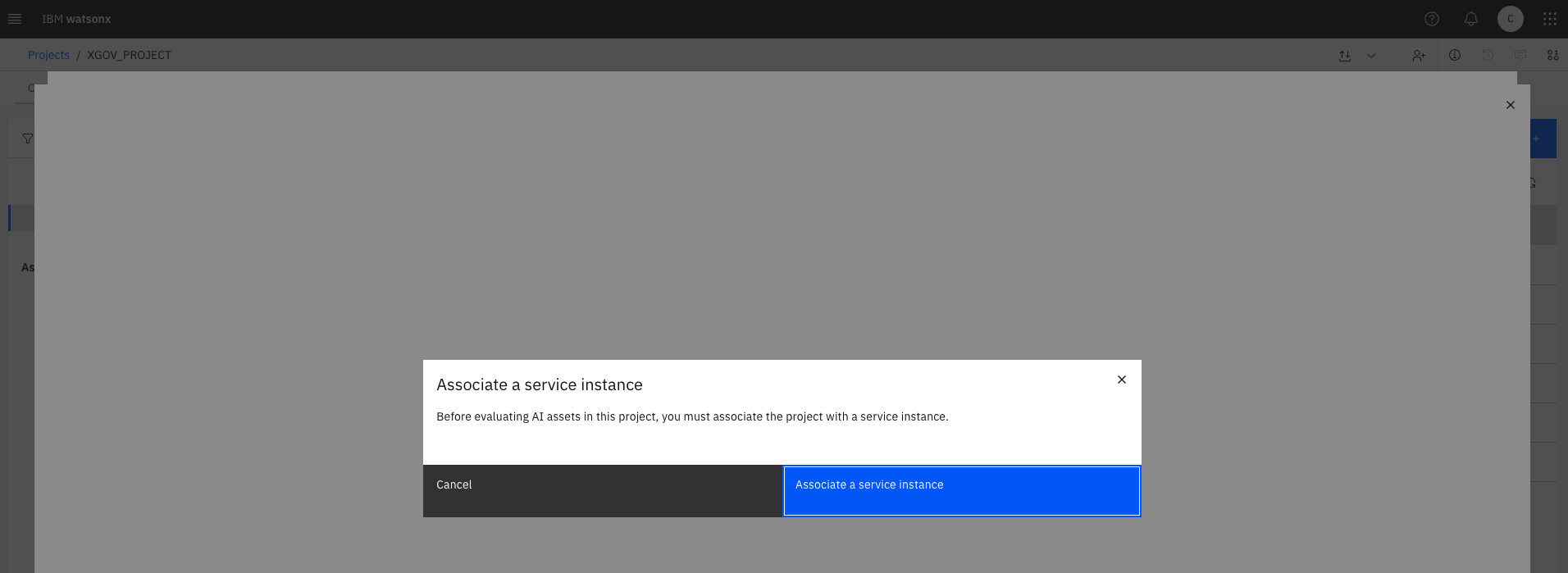

    You must be assigned the Admin role for your instance. If your project does not have an associated watsonx.governance instance, you must select Associate a service instance in the Associate a service instance dialog box to associate an instance with your project. associate service instance
