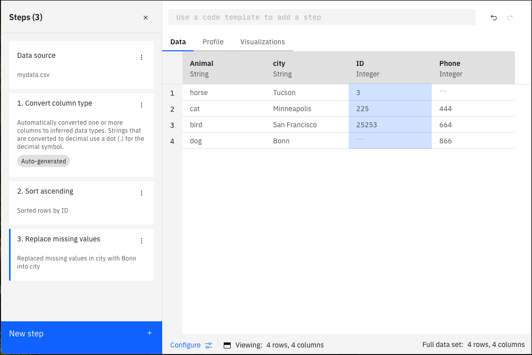

1. Access Data Refinery from within a project. Click New asset > Prepare and visualize data. Then select the data that you want to work with. Alternatively, from the Assets tab of a project, click a data asset to preview it, and then click Prepare data.
2. Use steps to apply operations that cleanse, shape, and enrich your data. Browse operation categories or search for a specific operation, then let the UI guide you. You can enter R code in the command line and let autocomplete assist you in getting the correct syntax. As you apply operations to a data set, Data Refinery keeps track of them and builds a Data Refinery flow. For each operation that you apply, Data Refinery adds a step.
Data tab
Data tab
If your data contains non-string data types, the Convert column type GUI operation is automatically applied as the first step in the Data Refinery flow when you open a file in Data Refinery. Data types are automatically converted to inferred data types, such as Integer, Date, or Boolean. You can undo or edit this step.
