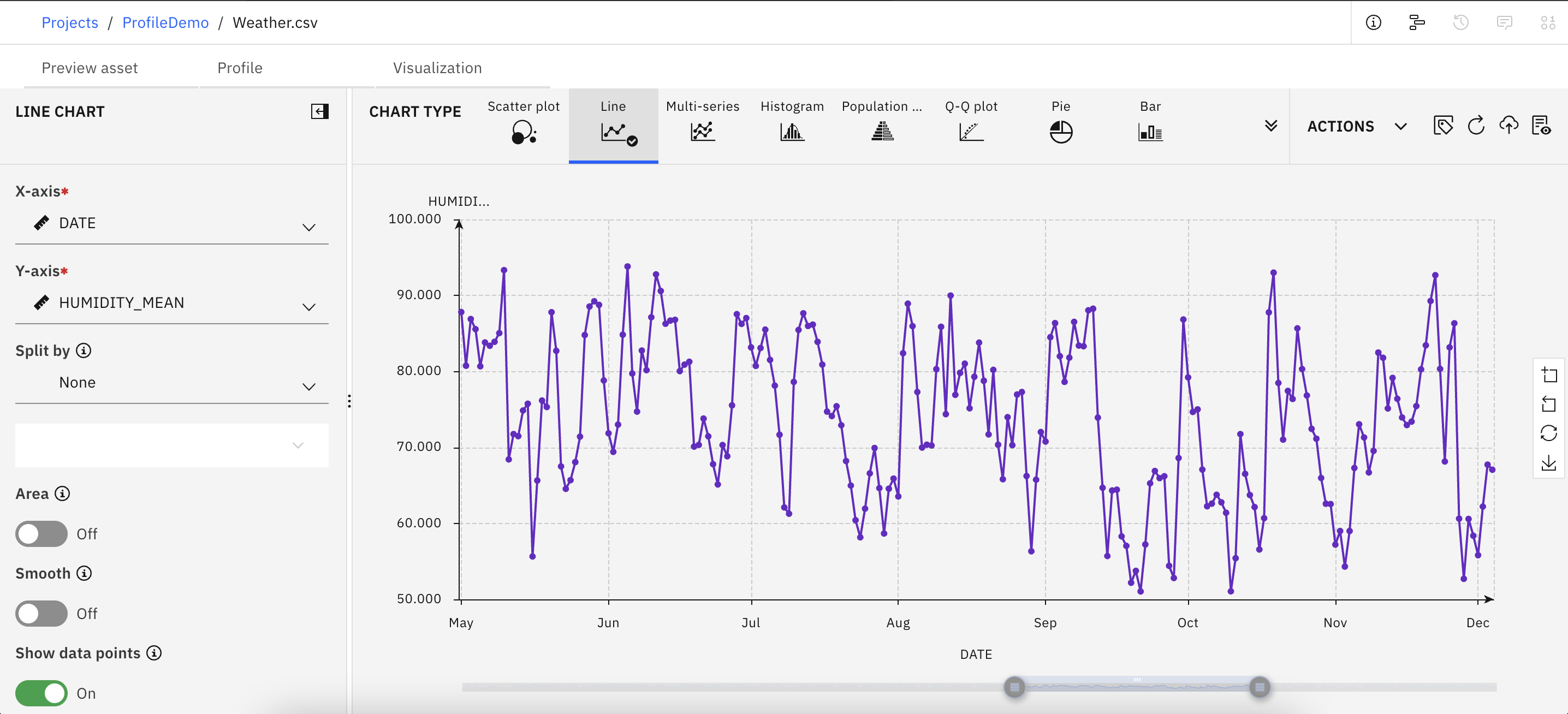

You can create graphics similar to the following example that shows how humidity values vary over time.
Example visualization

You can build a chart by selecting a predefined chart type from the Visualization tab.
To create visualizations that use an asset from your project:
  1. On the Assets tab of your project, click Data asset in the list of asset types, and select a data asset.
  2. Click the Visualization tab.
  3. Start with a chart or select columns. Select a chart and input your preferences in the DETAILS pane that opens.
    If you select columns first, the available charts are ordered starting with the most relevant, based on the selected columns. The best charts for your data are indicated with a dot next to the chart name. Depending on your chosen data, only charts and columns that support those data types are available.
    As you build the chart, the canvas displays a preview of the chart with variable labels and measurement levels that are taken from your data.
