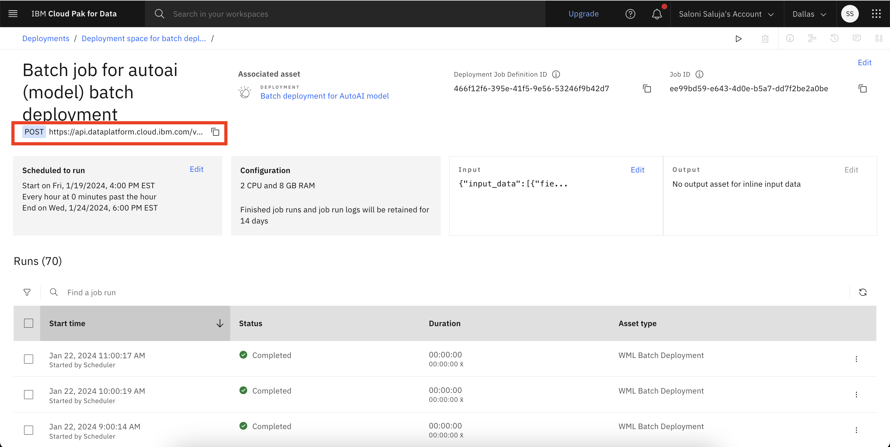

Retrieving the endpoint for a batch deployment
You must retrieve the endpoint URL to access your batch deployment from your applications. Follow these steps to get the endpoint URL for your batch deployment:
- From your deployment space, click the name of your batch deployment.
- From the deployment details page, click the name of your batch job.
If you don't have an existing batch job for your batch deployment, you must create one. For more information, see Creating jobs in a deployment space.
- From the batch job details page, you can access the endpoint URL for your batch deployment. Click the copy
icon to
copy the endpoint URL to your clipboard.
