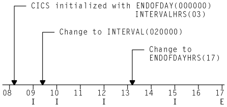

These rules are illustrated by the following example. I indicates an interval recording and E indicates an end-of-day recording. The system is started cold with STATRCD, the option that sets the initial value for the RECORDING switch, set to ON.
This example shows CICS initialized with ENDOFDAY(000000) and INTERVALHRS(03). There is also a change to INTERVAL(020000) and a change to ENDOFDAYHRS(17). A time scale marked from 08 to 17 shows I against 9, 10, 12 and 15, and E against 17.
