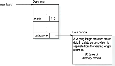

In the preceding code fragment, the call to mi_new_var() creates a new varying-length structure and sets the length field to 200. This call also allocates the 200-byte data portion (see Figure 2).
The following figure shows the format of the varying-length structure that new_lvarch references after the call to mi_set_vardata() successfully completes.
Figure 2. Format of a varying-length structure
begin figure description - This figure is described in the surrounding text. - end figure description
The mi_set_vardata() function copies from the local_var buffer the number of bytes that the data length specifies. Your code must ensure that the data-length field contains the number of bytes you want to copy. In the code fragment in Figure 1, the data-length field was last set by the call to mi_set_varlen() to 110 bytes. However, if the mi_set_varlen() function executed after the mi_set_vardata() call, the data length would still have been 200 bytes (set by mi_new_var()). In this case, mi_set_vardata() would try to copy 200 bytes starting at the location of the local_var variable. Because the actual local_var data only occupies 110 bytes of memory, 90 unused bytes remain in the data portion.
