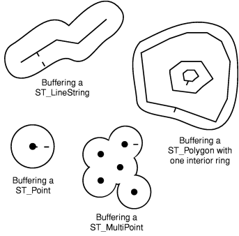

As shown in the following figure, ST_Buffer() generates a polygon or a multipolygon that surrounds a geometry at a specified radius.
Figure 1. Buffers generated by the ST_Buffer() function
This graphic shows the buffering of various geometric objects.
