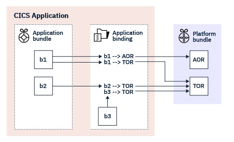

Figure 1. Example of binding an application to a platform. b1, b2, and b3 are CICS bundles.
Bundles b1, b2 and b3 are bound to one or more region types on the specified target platform.
