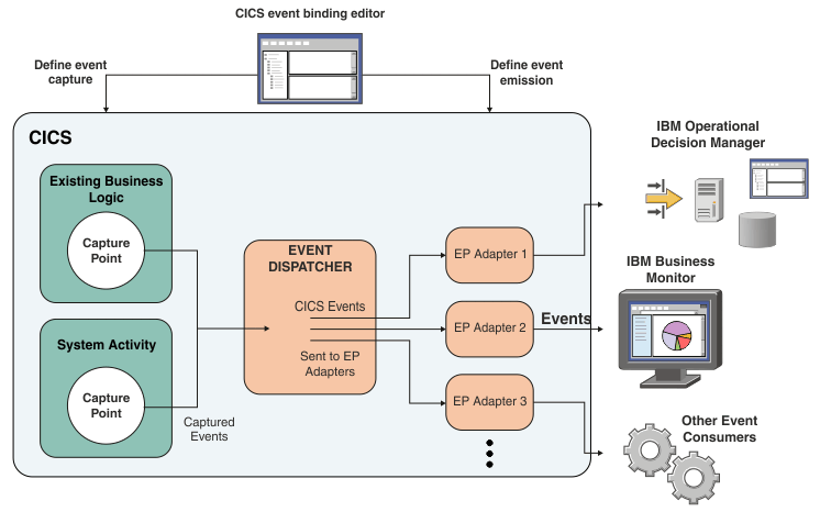

Figure 1. Event processing high-level architecture
This diagram shows the event binding editor being used to define application event capture points, system event capture points, and event processing adapters. The captured events are then passed to the event dispatcher for formatting and emission to various EP adapters. These events can then be consumed by WebSphere Business Events, WebSphere Business Monitor, or other event consumers.
Note: IBM Business Monitor, formerly known as WebSphere Business Monitor.
  1. You specify when to capture and emit events by using the event binding editor.
    • An event binding is created in a CICS bundle project
    • The criteria for capturing an event and the data to be included within the event are known as capture specifications and are saved in event bindings. Each capture specification relates to a particular capture point, for example following the EXEC CICS READ FILE API call or the point at which a file enable status is changed.
    • The event emission options including the required format and destination are specified in an EP adapter.
  2. You export the bundle to the z/OS UNIX file system and install it into CICS by using a BUNDLE resource.
    • CICS creates EVENTBINDING and EPADAPTER resources from the BUNDLE.
  3. CICS checks for active capture specifications whenever an event capture point is run.
    • If capture specifications are active at the capture point, CICS checks the filter criteria and captures the specified data for any that evaluate true.
  4. Captured events are passed to the event dispatcher for emission.
  5. The event dispatcher passes each event to the EP adapter specified for the event binding.
  6. The EP adapter formats the event and emits it to a destination according to its configuration options.
