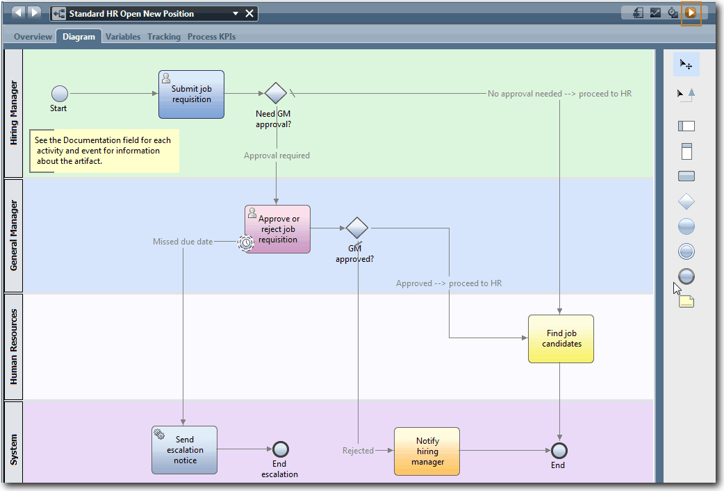

Run the Standard HR Open New Position process in the Inspector view in IBM® Process Designer to see a process model run step by step.
About this task

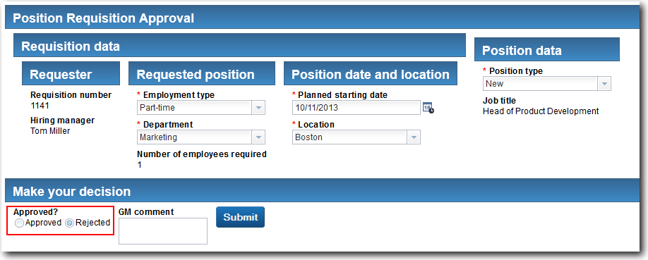

- The hiring manager submits a requisition to fill a new position. After submission, the requisition is routed to the GM for approval. If it is approved, the requisition is routed to HR. If it is rejected, the hiring manager is notified and the requisition is terminated.
- The hiring manager submits a requisition to fill an existing position. After submission, the requisition is routed to HR.

- Make sure that the Standard HR Open New Position process is open and the Diagram tab is selected.
- Click the Run Process icon to start
an instance of the process, as shown in the following image:
- When you are prompted to switch to the Inspector, click Yes. The process diagram displays in the Inspector.

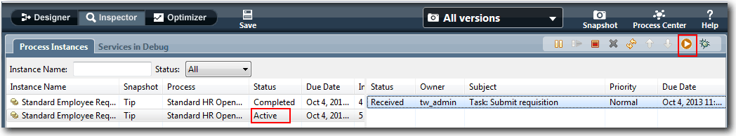

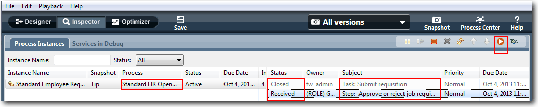

- To start a new instance of the Standard HR Open New Position process, click the Run Process icon as shown in the following image. The Process Instances view in the Inspector shows a new (active) process instance.
- Select the active instance in the left pane to display the new Submit requisition task in the right pane of the Process Instances view.

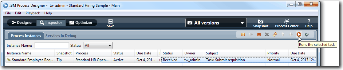

- Start the task in the Inspector by clicking the Task: Submit requisition
task then clicking the Run Process icon, as shown in the following
image:The "Submit requisition task" generates a Create Job Requisition Coach in a web browser.

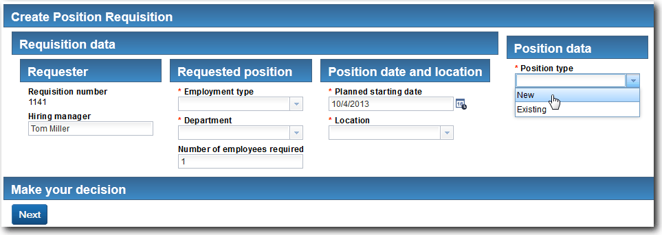

- Acting as the hiring manager, complete the requisition information.
- Set the Position Type to Existing.
- Click Next.

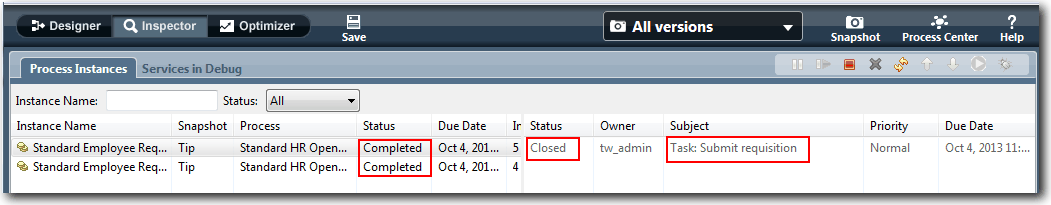

- Click the
icon to refresh

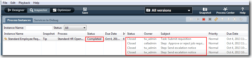

the Process Instances view. You can see that the Submit requisition
task is now closed. Because the hiring manager submitted a requisition
to fill an existing position, GM approval is not required and the
Standard HR Open New Position process instance is completed. You have now run the Hiring Sample process. If you like, you can rerun the process in the Inspector and run the paths that are not covered.
