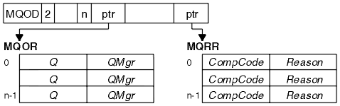

Figure 1 shows how you can open a distribution list in C.
Figure 1. Opening a distribution list in C. The MQOD uses pointers to the MQOR and MQRR structures.
The diagram shows an MQOD (Object Descriptor) data structure. The version number is identified as 2. The structure contains: the number of MQOR and MQRR entries; a pointer to a separate MQOR (Object Record) structure; a pointer to a separate MQRR (Response Record) structure. These structures are also shown, and each contains a list with the same number of entries. The number was given in the MQOD. The MQOR entries have fields for destination queue name and queue manager name. The MQRR entries have fields for completion code and reason code.
