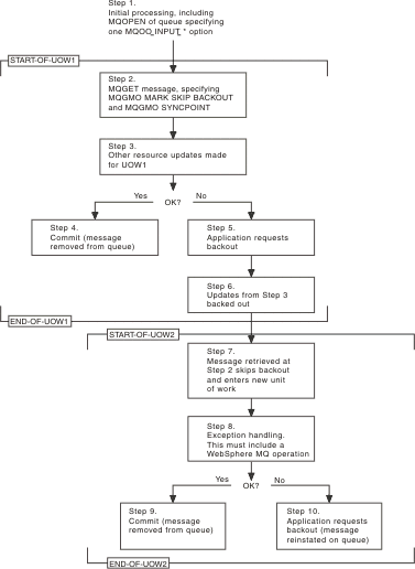

Figure 1 illustrates a typical sequence of steps that an application program might contain when an MQGET request is required to skip backout.
- Step 1
- Initial processing occurs within the transaction, including an MQOPEN call to open the queue (specifying one of the MQOO_INPUT_* options in order to get messages from the queue in Step 2).
- Step 2
- MQGET is called, with MQGMO_SYNCPOINT and MQGMO_MARK_SKIP_BACKOUT. MQGMO_SYNCPOINT is required because MQGET must be within a unit of work for MQGMO_MARK_SKIP_BACKOUT to be effective. In Figure 1 this unit of work is referred to as UOW1.
- Step 3
- Other resource updates are made as part of UOW1. These can include further MQGET calls (issued without MQGMO_MARK_SKIP_BACKOUT).
- Step 4
- All updates from Steps 2 and 3 complete as required. The application program commits the updates and UOW1 ends. The message retrieved in Step 2 is removed from the queue.
- Step 5
- Some of the updates from Steps 2 and 3 do not complete as required. The application program requests that the updates made during these steps are backed out.
- Step 6
- The updates made in Step 3 are backed out.
- Step 7
- The MQGET request made in Step 2 skips backout and becomes part of a new unit of work, UOW2.
- Step 8
- UOW2 performs exception handling in response to UOW1 being backed out. (For example, an MQPUT call to another queue, indicating that a problem occurred that caused UOW1 to be backed out.)
- Step 9
- Step 8 completes as required, the application program commits the activity, and UOW2 ends. As the MQGET request is part of UOW2 (see Step 7), this commit causes the message to be removed from the queue.
- Step 10
- Step 8 does not complete as required and the application program backs out UOW2. Because the get message request is part of UOW2 (see Step 7), it too is backed out and reinstated on the queue. It is now available to further MQGET calls issued by this or another application program (in the same way as any other message on the queue).
