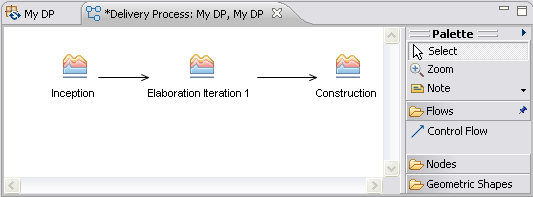

- In the Work Breakdown Structure tab right-click My DP and select Open Activity Diagram. Click OK to create a new diagram file. The diagram editor opens, showing the top level activities (phases).
- Expand the palette on the right of the diagram view if not already expanded. All elements required to create an activity diagram are available on the palette.
- Right-click the diagram workspace and select Add > Phase to add a new phased called "Construction" to the diagram.
- Using the Control Flow tool, create links between the phases
to show the sequence of the phases.
- Switch back to the Work Breakdown Structure view of My DP and notice the new phase. Also notice that the links you added on the diagram are reflected in the Predecessors column.
