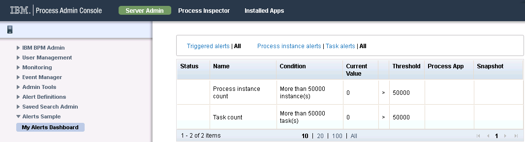

The My Alerts Dashboard displayed in the Process Admin Console
This example is just one way that you can make administrators aware of when the number of process instances or tasks go under, reach, or exceed a specified threshold value. For example, you can use the APIs to create emails that are sent to administrators or create a web page that administrators can access outside of the Process Admin Console.
Create the alert business object
In the sample, AlertStatusSummary business object contains information about alert definitions that the user sees in the dashboard.
The example dashboard uses a table with each row representing a different alert definition through a different instance of AlertStatusSummary.

In the sample, the user selects the filters through the following user interface on the dashboard:
The first filter is triggered alerts or all alerts. The second filter is process instance alerts, task alerts, or all alerts

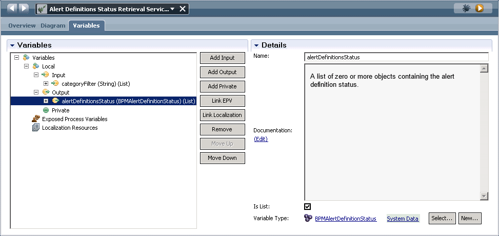

  1. Create an integration service called Alert Definitions Status Retrieval Service.
  2. Add the following input variable:
    • categoryFilter(String)(List)
    The service accepts this input to determine which type of alert definitions to retrieve.
  3. Add the following output variable:
    • alertDefinitionsStatus(BPMAlertDefinitionStatus)(List)
    The output variable contains the list of alert definitions that the service retrieved based on the type of alerts that the user wants to see. The BPMAlertDefinitionStatus type is in the System Data toolkit to support BPM alerts.
    The input and output variables of the integration service

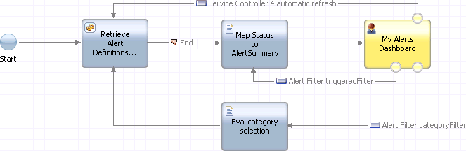

  3. In the human service diagram, add a nested service, two server scripts, and a coach. Rename them using the information in the following table:
    Artifact New Name
    Nested service Retrieve Alert Definitions
    Server Script Map Status to AlertSummary
    Server Script (1) Eval category selection
    Coach My Alerts Dashboard

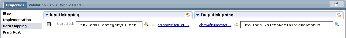

  4. Select the nested service and then set its properties:
    1. In its Implementation properties, attach the Alert Definitions Status Retrieval Service that you created in the previous section.
    2. In the input mapping of the Data Mapping properties, map the categoryFilter variable of the human service to the categoryFilter variable of the Alert Definitions Status Retrieval Service.
    3. Similarly, in the output mapping, map the alertDefinitionsStatus variable of the Alert Definitions Status Retrieval Service to the alertDefinitionsStatus variable of the human service.
    Data mapping properties of the nested service

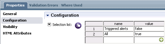

    10. Select the first Alert Filter instance. In its General properties, bind the instance to the selectedTriggeredFilter variable. To distinguish between the boundary events broadcast by the Alert Filter instances, append triggeredFilter to the label.
    11. In its Configuration properties, expand Selection list. Add the following name-value pairs:
      Name Value
      Triggered alerts false
      All true
      Name value pairs for first filter
      The names are what the filter displays at run-time.

    1. In the palette, open the Variables area. Drag the alertStatusSummaries variable onto the diagram. The diagram displays a table that contains a column for each parameter of the variable.
    2. To shorten the headings in the dashboard table, change the labels for the following controls:
      Default Control Label New Label
      Display name Name
      Threshold operator
      Threshold value Threshold
      Project display name Process App
      Snapshot display name Snapshot
      Bpd display name Process
    3. For the Threshold operator control, set its label visibility to Hide.

  1. In the My Alerts Dashboard diagram, make the following connections:
    From To
    Start Retrieve Alert Definitions
    Retrieve Alert Definitions Map Status to AlertSummary
    Map Status to AlertSummary My Alerts Dashboard
    My Alerts Dashboard Retrieve Alert Definitions using the boundary event of the Service Controller
    My Alerts Dashboard Map Status to AlertSummary using the boundary event of the triggeredFilter Alert Filter
    My Alerts Dashboard Eval category selection using the boundary event of the categoryFilter Alert Filter
    Eval category selection Retrieve Alert Definitions
    The heritage human service diagram
