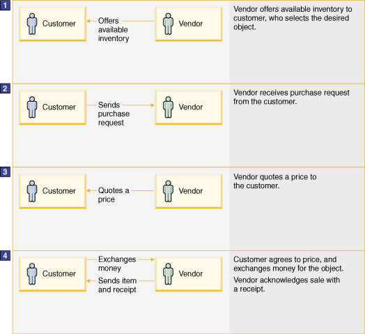

An example of a simple business process
Let us begin with an example of a simple business process. This figure illustrates the steps involved when a vendor sells an item to a customer.
Figure 1. A simple real-world business process
A graphical representation of a simple business process.

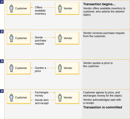

In fact, you have already been exposed to a transaction. Take a look at the simple business process example again, as shown here with a few minor additions.
Figure 2. A simple business transaction
Graphical representation of a basic business transaction
There are a few new terms added to the figure, the most important of which is the term committed. This is a key concept in understanding what a transaction is. Simply put, a transaction is not complete until it has fully completed and the results locked in place. Take a look at the figure again, and you'll note that at any time before commitment, the whole process could be canceled easily without complication. However, once it has been committed it can no longer be undone so simply, and the actions that took place must instead be compensated. This term will be discussed in more detail later in this topic.
Essentially, all business processes consists of at least one transaction, but this alone does not make a process transactional. To be transactional, the process must be composed of a number of individual transactions, and these transactions can be composed either of one single activity, or a group of activities. Each activity in your process must belong to exactly one transaction, and each activity must commit its operation before the processing continues. The importance of transactions relate to the concept of compensation (see below) as they are predefined points where the business process can be stopped either to record all accumulated activities, or to roll it back to a previous point.
