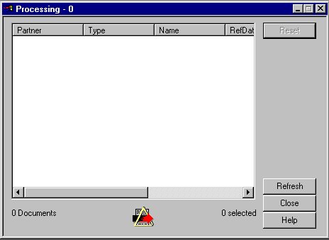

The Processing browser contains a list of documents that the system is currently processing.
Note: The Processing browser displays the current status of the processing document. If the document is processing, the status code is set to 1. If the document or acknowledgement is deferred, the status code is set to 2.
The following illustrates the Processing browser:
The following describes the parts of the Processing browser.
Part Function
Partner Name of the partner associated with the document.
Type Type of document being processed.
Name Name of the document.
Status Status of the document.
Reset Returns to their previous location any documents that are displayed on this dialog box but for which processing has terminated.
Note: This function is typically used for exception cases when the processing of a document terminated improperly.
