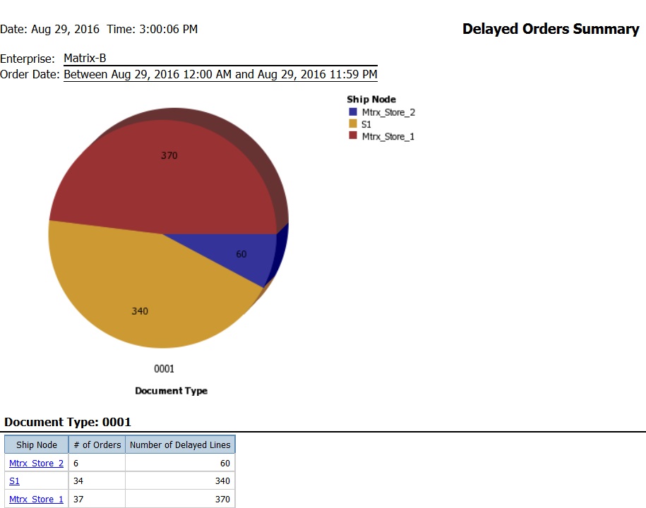

  • Delayed Orders Report - a pie chart is displayed with the Delayed Order Distribution based on the number of delayed order lines that are associated with an allocated node. When you move the mouse pointer over an allocated node in the Delayed Order Distribution in the pie chart, a hover help is displayed indicating the exact number of delayed order lines.
    A report showing a pie chart with the numbers of delayed orders
