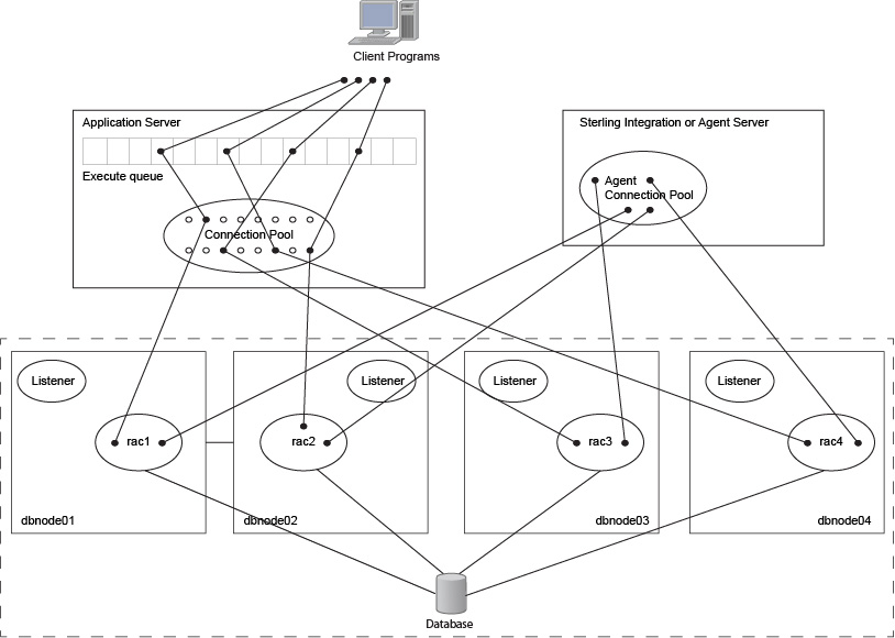

RACDB is the net_service_name for client-side load balancing, as illustrated in the following figure:
A diagram depicting load balancing on the client side.
