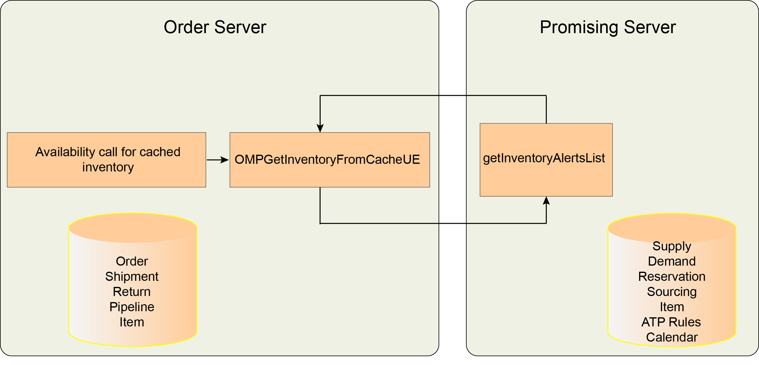

Promising server and availability from cache
When getItemListforOrdering
API
calls are made on the Order server to get availability from cache,
the OMPGetInventoryFromCacheUE is invoked, which in turn calls the
GetInventoryAlertsService on the Promising server. The GetInventoryAlertsService
internally calls the getInventoryAlertsList
API.
The following diagram shows the availability from cache process flow.
