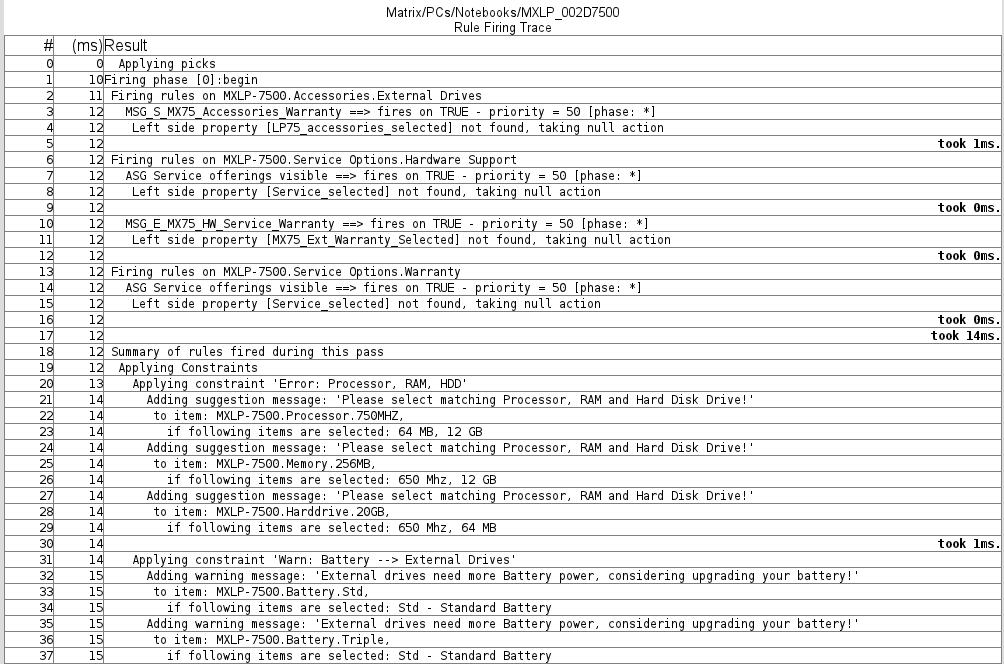

The rule firing trace has three columns:
- A sequence number, useful for communicating with others about rule issues. It's easy to tell someone, "See line 35, where it says Xxx?"
- Elapsed time. This logs how long it took from the time the log entry was made until the start of rule firing.
- The body of the trace log. This displays the aspects of the rule
firing, such as a condition being evaluated, an assignment occurring,
the start of a rule or the conclusion of a rule, and so on. The log
also displays the following aspects:
- The number of milliseconds needed to fire a rule after each rule firing entry.
- The total number of milliseconds needed to run the model is logged at the end of the rule firing trace.
- The messages written for constraints as part of rule and constraint evaluation.
- The number of milliseconds needed to apply a constraint, after applying each constraint

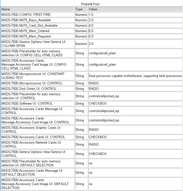

The property pool trace also presents three columns:
- Name is the full path name to the item and the property on that item.
- Type is the property type for the named property, such as Numeric, List, or String.
- Value is the value of the property after the rule has fired.
The following illustration shows a section of a sample property pool trace:
Use this log "single user" to get a feel for how extensive the rules are per click. Check how long is it taking to fire the rules. If the answer is more than 100-200ms you may have scalability problems. If you do, use the trace log to figure out if any particular rules are performing badly.
