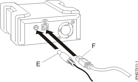

- The external USB disk drive can be installed while the system is powered on and needs to be configured following the installation.
To install the docking station, complete the following steps:
