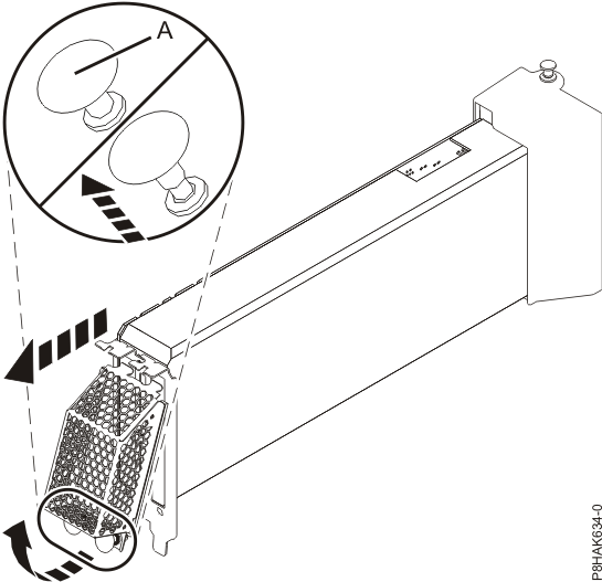

the adapter, component-side up, on a flat, antistatic surface. Note: Some PCIe adapters are shipped from the manufacturer with a blue handle or support bracket along the back edge of the adapter. To use adapters of this type, you must remove the blue handle or the support bracket from the adapter.Attention: A pin on the tailstock of the adapter resembles a removable screw. Do not remove this pin. It is required for correct alignment and seating.Note: The PCIe gen3 x16 GPU adapter (feature code EC47 or EC4B) has a protective shield that is attached to the tailstock. The protective shield is attached to the rear bulkhead after you install the adapter. The adapter has an air baffle that is attached at the edge opposite to the tailstock. Do not attempt to remove the air baffle. To remove the protective shield, pull out the locking button as shown in Figure 1. Holding the protective shield, disengage the shield from the tailstock and then pull out the shield.Figure 1. Removing the protective shield from the GPU adapter

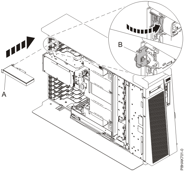

- If the adapter latch (B) at
the target slot is not already in the open position, pull the latch
into the open position by rotating the latch outwards from its clip
on the back of the system, as shown in Figure 4 and Figure 5. Attention: Before you insert the adapter in the PCIe slot, ensure that the adapter has no cables, protective shields, or transceivers that are attached to it. If the adapter has cables, protective shields, or transceivers that are attached, remove them. For instructions to remove protective shields or transceivers, see Removing and replacing the tailstock on a PCIe adapter. The cables, protective shields, or transceivers must be attached to the adapter after the adapter is inserted in the PCIe slot.

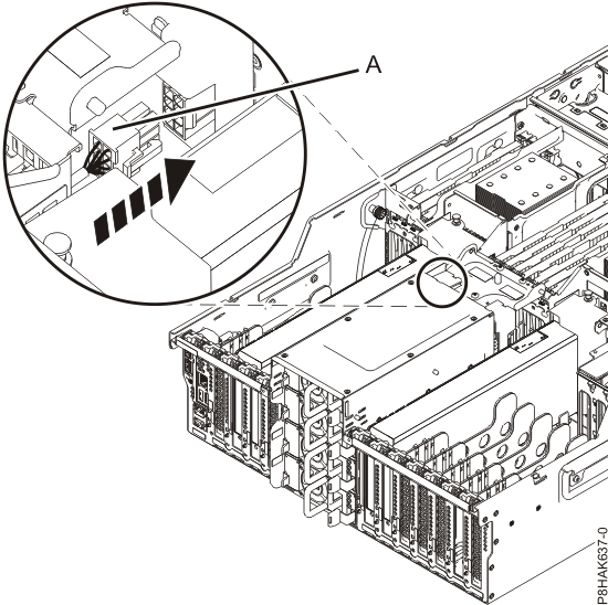

- If you are installing or replacing the PCIe gen3 x16 GPU adapter (FC EC47 or EC4B) in an 8247-42L system, connect the auxiliary power cable
(A) to its connectors on the system backplane, as shown in Figure 2.
If you are installing or replacing any other adapter, go to the next
step. Figure 2. Connecting the power cords for the GPU adapter PCIe adapter in the 8247-42L system
- Carefully grasp the adapter by its top edge or tailstock, and align the adapter with the slot and its connector on the system backplane (A), as shown in Figure 4 and Figure 5.

- On the system, press the adapter firmly into its connector.
- To lock the adapter in
its slot, rotate the adapter latch (B) in the
direction that is shown in Figure 4 and Figure 5. Figure 4. Installing or replacing a PCIe adapter in a rack-mounted system
