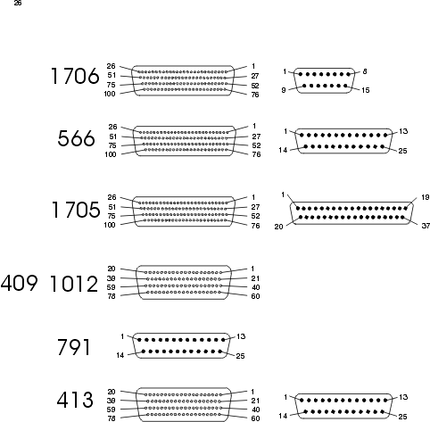

8-Port EIA-232E/RS-422A Adapter 78-position
and 25-position connectors
The 8-Port asynchronous EIA-232E/RS-422A
PCI adapter is shipped with a connector box that provides eight 25 pin D-shell
standard connectors.
Figure 3. 25 pin D-shell standard connectors
