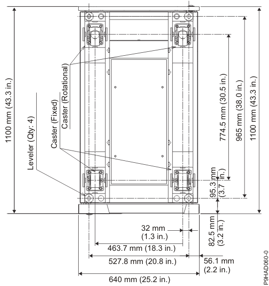

Figure 1 provides the caster and leveler locations for 7014-T00 and 7014-T42 racks.
Figure 1. Caster and leveler locations
Note: Rack units are large and heavy and are not easily moved. As maintenance activities require access at both the front and the back, extra room is needed. The footprint illustration does not show the radius of the swinging doors on the I/O rack. A service clearance of 915 mm (36 in.) needs to be maintained on front, rear, and sides of the I/O rack.

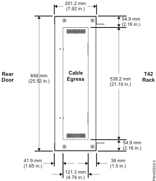

Feature code (FC) ERG0
FC ERG0 is an optional rear rack extender that can be used for 7014-T42 racks. The extender is installed on the rear of the 7014-T42 rack and provides 203 mm (8 in.) of extra space to hold cables on the side of the rack and to keep the center area clear for cooling and service access.
Figure 2. FC ERG0 rear rack extender (top-down view)
