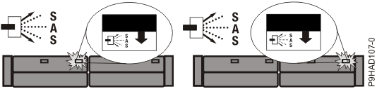

  • Each cable end has a label that graphically describes the correct component port to which it is connected, such as:

The following table contains cable label information. The graphic labels are designed to match the correct component port to which the cable end is to be attached.
Table 4. SAS cable labeling
Name Connects Label
SAS 4x AE cable SAS adapter to a media expansion drawer or two SAS adapters to a disk expansion drawer in a unique JBOD configuration
SAS 4x AE cable (1 m)
SAS 4x AE cable (3 m and 6 m)
SAS AA cable
SAS adapter to SAS adapter
SAS AA cable (1 m)
SAS YO cable
SAS adapter to a disk expansion drawer
SAS YO cable (1 m)
SAS YO cable
SAS X cable
Two SAS adapters to a disk expansion drawer in a RAID configuration
SAS X cable (1 m)
SAS X cable

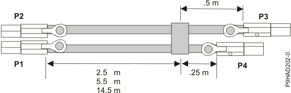

Cable section lengths
Figure 1. SAS external X cable assembly cable lengths
SAS external X-cable assembly cable lengths
Figure 2. SAS external YO-cable assembly cable lengths

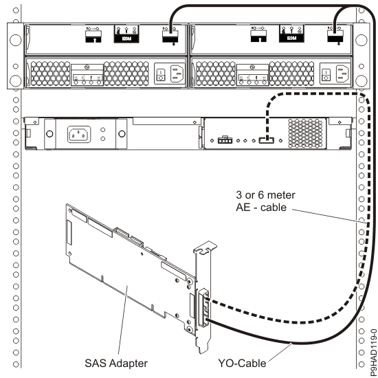

SAS adapter to expansion drawer combinations
Figure 4 illustrates connecting a PCIe SAS adapter to both a disk expansion drawer and a media expansion drawer on separate adapter ports.
Figure 4. SAS adapter to both a disk expansion drawer and a media expansion drawer
Note: The YO cable must be routed along the right side of the rack frame.

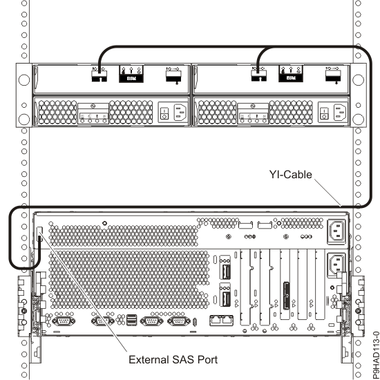

System external SAS port to disk expansion drawer
Figure 5 illustrates connecting a system external SAS port to a disk expansion drawer. Disk expansion drawers cannot be cascaded.
Figure 5. System external SAS adapter port to a disk expansion drawer

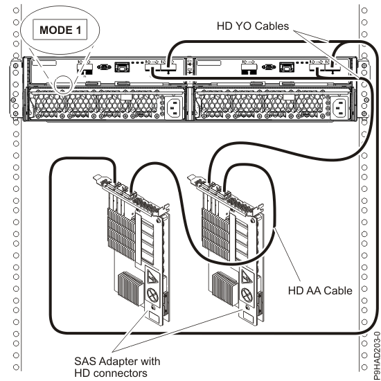

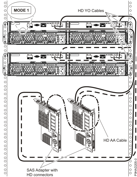

Two RAID SAS adapters with HD connectors to disk expansion drawer in a multi-initiator high availability (HA) mode (dual storage adapter configuration)
Figure 6, Figure 7, and Figure 8 illustrate connecting two SAS RAID adapters with HD connectors to one, two, or three disk expansion drawers in a multi-initiator HA mode.
Figure 9 illustrates connecting two pair of SAS RAID adapters with HD connectors to one disk expansion drawer in a multi-initiator HA mode.
Figure 6. Two RAID SAS adapters with HD connectors to a disk expansion drawer in a multi-initiator HA mode
Notes:
  • No cascading allowed for the 5887 storage drawer.
  • The 5887 storage drawer is connected to same numbered port on each adapter.
  • HD AA cable is required.

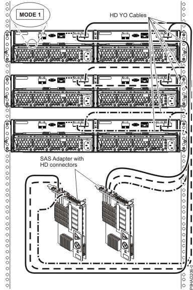

Figure 8. Two RAID SAS adapters with HD connectors to three disk expansion drawers in a multi-initiator HA mode
Note:
  • The 5887 storage drawers are connected to same numbered port on each adapter.

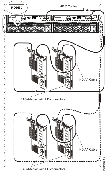

Figure 9. Two pairs of RAID SAS adapters with HD connectors to a disk expansion drawer – Mode 2 in a multi-initiator HA mode
Two pairs of RAID SAS adapters with HD connectors to a disk expansion drawer – Mode 2 in a multi-initiator HA mode.
Notes:

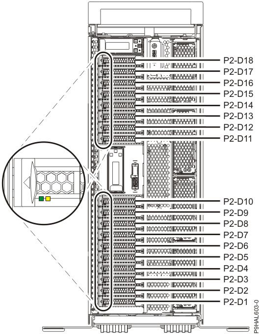

Internal disk drive sharing
The following information is for use after the FC 5901 SAS Storage adapter is installed. Install the adapter and then return here. For more information about the PCI adapters topic, see Installing PCIe adapters in the 9008-22L, 9009-22A, or 9223-22H system.
Please review the tasks in the Before you begin section before you proceed with the following procedure.
This feature allows you to split the internal disks in the system unit enclosure into groups that you can manage separately.
  1. Stop and power off the system. For more information, see Stopping a system or logical partition.
  2. Cable a single system unit enclosure by completing the following steps:
    1. Attach the cable to the SAS port on the rear bulkhead of the system unit enclosure to the top port in the SAS Storage Controller as shown in the following figure.
      Restriction: Internal disk drive sharing is only available when internal cable feature FC 1815 is installed from the DASD backplane to the read bulkhead of the system unit enclosure. Also FC 5662 175 MB cache RAID - dual IOA enablement card must not be installed. The SAS Storage Controller might be in any of the other slots that support it.
    2. Secure any extra cable.
  3. Start the system. For more information, see Starting the system or logical partition.
  4. Verify that the feature is installed and is working. For more information, see Verifying the installed part.
With this function installed, two of the six disks (D3 and D6) in the system enclosure is managed by the SAS storage controller adapter.
Note: The removable media device is always controlled by the separate embedded SAS controller on the system board.
