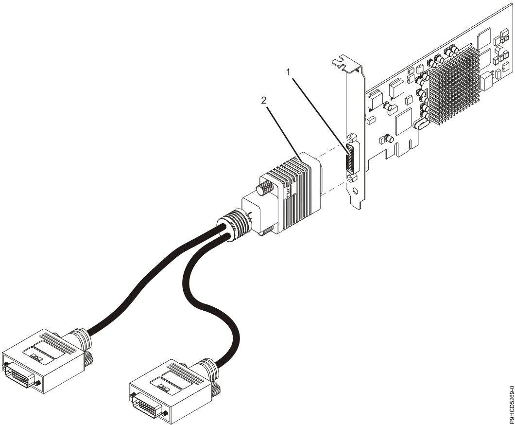

The PCIe POWER GXT145 graphics accelerator adapter is a versatile 2D graphics accelerator and enhances the system unit video. This adapter supports both analog and digital monitors. The adapter requires a PCI Express slot. A short converter cable is included which adapts the 28-pin port on the adapter to dual DVI-I (analog/digital video) connectors. The adapter has no hardware switches to set. Mode selection is made through the software. The figures below show the adapters.
- 1
- DVI connector (28 pin), analog, or digital
- 2
- Converter cable with dual DVI-I (analog/digital video) connectors
If your monitor has a DVI connector, connect it directly to the main DVI connector (labeled 1/3) of your converter cable.
If attaching a device that requires a 15 pin D-Shell receptacle for a VGA connection (that is, when the graphic adapter output is routed directly to a 7316-TF3 display or indirectly through a KVM switch), order a VGA to DVI Connection Converter, feature number 4276 and connect it to the main DVI connector (labeled 1/3) of your converter cable.
If you're connecting only one monitor, use the main connector (labeled 1/3) of your converter cable.
