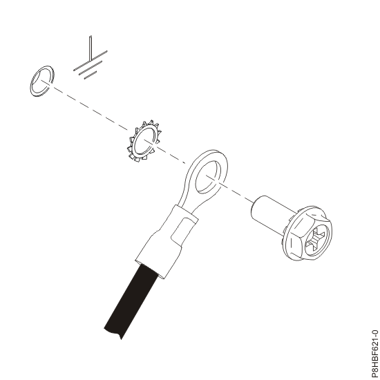

  3. Place one ring terminal and then one external star washer on the bolt.
    The following figure shows the order in which the screw, ring terminal, and external star washer are installed.
    graphic showing the screw, ring terminal, and external star washer
    Figure 2. Ring terminal and external star washer
  4. Use the external star washer and m5 bolt to secure the wire to the door ground point.
  5. Place the other wire connector ring on the screw and add the M6 external star washer, as shown in Figure 2.
