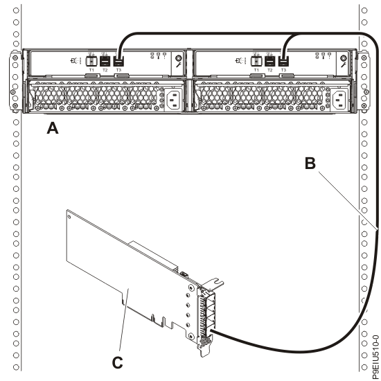

- Single SAS adapter to one ESLL or ESLS storage enclosure by using a
mode 1 connection.
- Connection by using SAS YO12 cables to connect to the ESLL or ESLS storage enclosure.
Figure 1. Mode 1 connection of one ESLL or ESLS storage enclosure by using a YO12 cable to a single SAS adapter

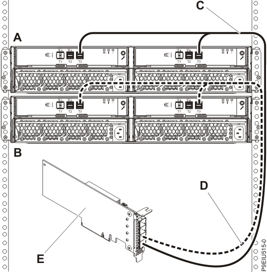

- Single SAS adapter to two ESLL or ESLS storage enclosures by using a mode 1 connection.
Figure 2. Mode 1 connection of two ESLL or ESLS storage enclosures by using YO12 cables to a single SAS adapter

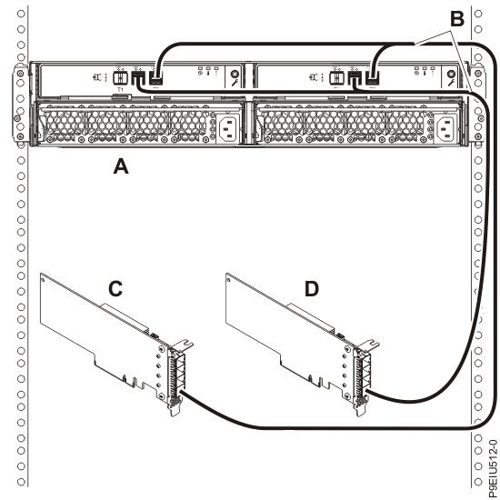

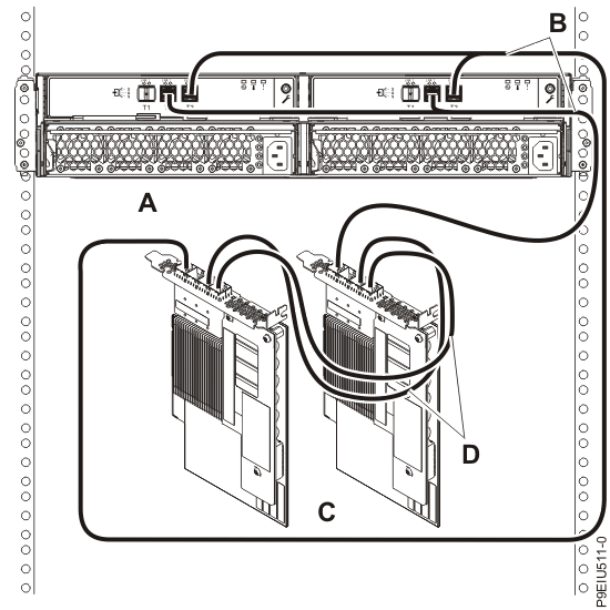

- One pair of SAS adapters to one ESLL or ESLS storage enclosure by
- For SAS adapter pairs, you must attach the SAS cables to the same port on both adapters.
Figure 3. Mode 1 connection of one ESLL or ESLS storage enclosure by using YO12 cables to one pair of SAS adapters

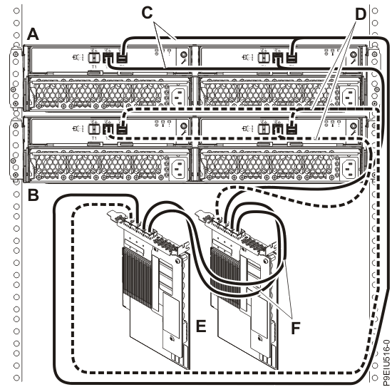

- One pair of SAS adapters to two ESLL or ESLS storage enclosures by using a mode 1 connection.
- For SAS adapter pairs, you must attach the cables to the same port on both adapters.
- Connection by using dual SAS YO12 cables to connect to the 5887 enclosure.
Figure 4. Mode 1 connection of two ESLL or ESLS storage enclosures by using YO12 cables to one pair of SAS adapters

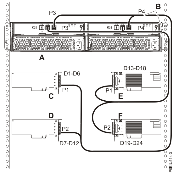

- Two pairs of SAS adapters to one ESLL or ESLS storage enclosure by
using a mode 2 connection.
- Connection by using SAS X12 cables to connect to the ESLL or ESLS storage enclosure.
Figure 6. Mode 2 connection of one ESLL or ESLS storage enclosure by using X12 cables to two pairs of SAS adapters

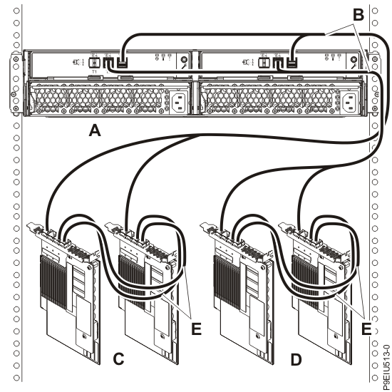

- Four independent SAS adapters to one ESLL or ESLS storage enclosure
by using a mode 4 connection.
Figure 7. Mode 4 connection of one ESLL or ESLS storage enclosure by using X12 cables to four independent SAS adapters
