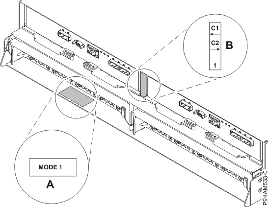

Confirm the factory-set mode of the enclosure by using information
that is printed on stickers at the rear of the enclosure. Stickers are attached to the lower-left
shelf of the chassis (A) and the center support between the enclosure
services manager modules (B). The stickers indicate whether the enclosure is
set to mode 1, mode 2, or mode 4.
Figure 1. Mode sticker locations at the rear of the enclosure

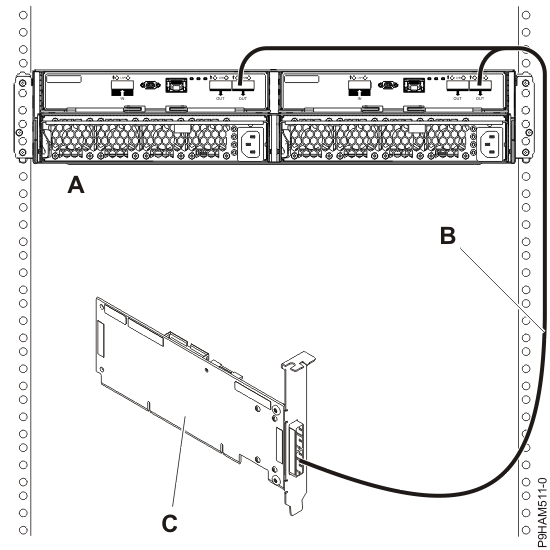

Complete a mode 1 connection of one enclosure (A) by using a YO cable
(B) to a single SAS adapter (C) as shown in Figure 2, and then continue with Connecting cables, power cords, and installing covers.
Note: The single SAS adapter (C) has access to all 24 drive bays.
Figure 2. Mode 1 connection of one enclosure by using a YO cable to a single SAS adapter

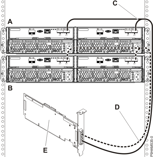

Complete a mode 1 connection of two enclosures (A and B) by using YO
cables (C and D) to a single SAS adapter (E) as shown
in Figure 3.
Note: The single SAS adapter (E) has access to all 48 drive bays.
Figure 3. Mode 1 connection of two enclosures by using YO cables to a single SAS adapter

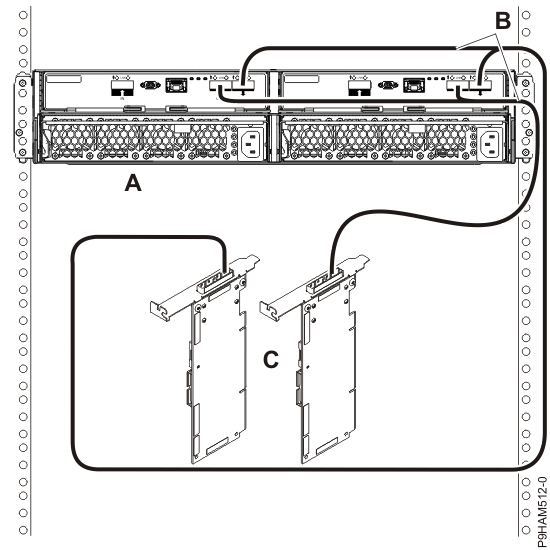

using YO cables (B) to a SAS adapter pair (C) as shown
in Figure 4, and then continue with Connecting cables, power cords, and installing covers.
Note: The single SAS adapter (E) has access to all 48 drive bays.Notes:
- Each adapter in the SAS adapter pair (C) has access to the other adapter and to all 24 drive bays.
- If 6 Gb SAS adapters are being used, they must be cabled by using 6 Gb SAS cables.
- For SAS adapter pairs, you can attach the cables to any adapter port when you use the same port in both adapters.
Figure 4. Mode 1 connection of one 5887 disk drive enclosure by using YO cables to a SAS adapter pair

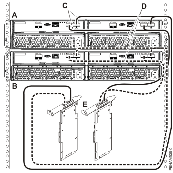

B) by using YO cables (C and D) to a SAS adapter pair
(E) as shown in Figure 5,
Notes:
- Each adapter in the SAS adapter pair (E) has access to the other adapter and to all 48 drive bays.
Figure 5. Mode 1 connection of two 5887 disk drive enclosures by using YO cables to a SAS adapter pair

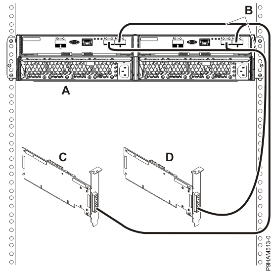

Complete a mode 2 connection of one 5887 disk drive enclosure
(A) by using YO cables (B) to two independent SAS
adapters (C and D) as shown in Figure 6 and then continue with Connecting cables, power cords, and installing covers.
Notes:
- Independent SAS adapter 1 (C) does not have access to the other independent adapter and has access only to drive bays D1 - D12.
- Independent SAS adapter 2 (D) does not have access to the other independent adapter and has access only to drive bays D13 - D24.
Figure 6. Mode 2 connection of one 5887 disk drive enclosure by using YO cables to two independent SAS adapters

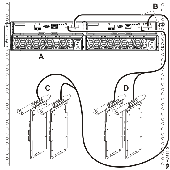

Complete the mode 2 connection of one enclosure (A)
by using X cables (B) to two SAS adapter pairs (C and
D) as shown in Figure 7, and then
Notes:
- Each adapter in the SAS adapter pair 1 (C) has access to the other adapter and to drive bays D1 - D12.
- Each adapter in the SAS adapter pair 2 (D) has access to the other adapter and to drive bays D13 - D24.
Figure 7. Mode 2 connection of one 5887 disk drive enclosure by using X cables to two SAS adapter pairs

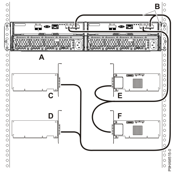

Complete a mode 4 connection of one enclosure (A) by
using X cables (B) to four independent SAS adapters (C, D, E, and
F) as shown in Figure 8, and then
Note: Refer to Figure 9 for examples of the P1 and P2 identifiers.
- The cable that plugs into independent SAS adapter 1 (C) contains a label with the P1 identifier (G). This adapter does not have access to any other independent adapter and has access only to drive bays D1 - D6.
- The cable that plugs into independent SAS adapter 2 (D) contains a label with the P2 identifier (G). This adapter does not have access to any other independent adapter and has access only to drive bays D7 - D12.
- The cable that plugs into independent SAS adapter 3 (E) contains a label with the P1 identifier (G). This adapter does not have access to any other independent adapter and has access only to drive bays D13 - D18.
- The cable that plugs into independent SAS adapter 4 (F) contains a label with the P2 identifier (G). This adapter does not have access to any other independent adapter and has access only to drive bays D19 - D24.
Figure 8. Mode 4 connection of one 5887 disk drive enclosure by using X cables to four independent SAS adapters
