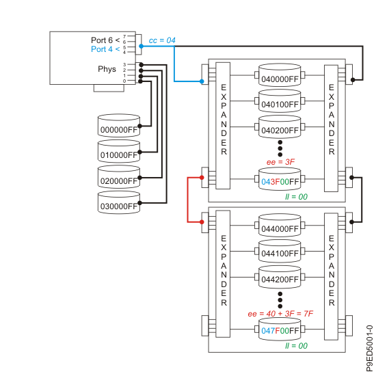

Many hardware error logs identify the location of a physical device, such as a SAS disk, using the unit address.
Unit Address Format prior to IBM® i 7.1 Technology Refresh PTF Group, Level 8
The unit address format is cceellFF, where:
- cc identifies the controller port to which the device, or device enclosure, is attached.
- ee is the expander port to which the device
is attached. When a device is not connected to a SAS expander, the
expander port is set to zero. Note: Generally, the range of the expander port is 00 to 3F hex. A value greater than 3F indicates there are two expanders (for example, cascaded expanders) between the controller and device. For example, a device connected through a single expander might show an expander port of 1A, while a device connected through a cascaded expander might show an expander port of 5A (that is, a value of 40 hex added to the expander port indicates the presence of a cascaded expander), but in both cases, the device is connected off port 1A of the expander.
- FF indicates that the expander port is not known.
- ll is the logical unit number (LUN) of the device. A value of FF indicates the LUN is not known.
A resource can identify a physical device or it can identify other SAS components. For example:
- FFFFFFFF indicates the identity of the device is not known or indicates a SAS RAID controller.
- ccFFFFFF identifies only a controller SAS port.
- cceellFF identifies the controller port, expander port, and LUN of an attached device.
