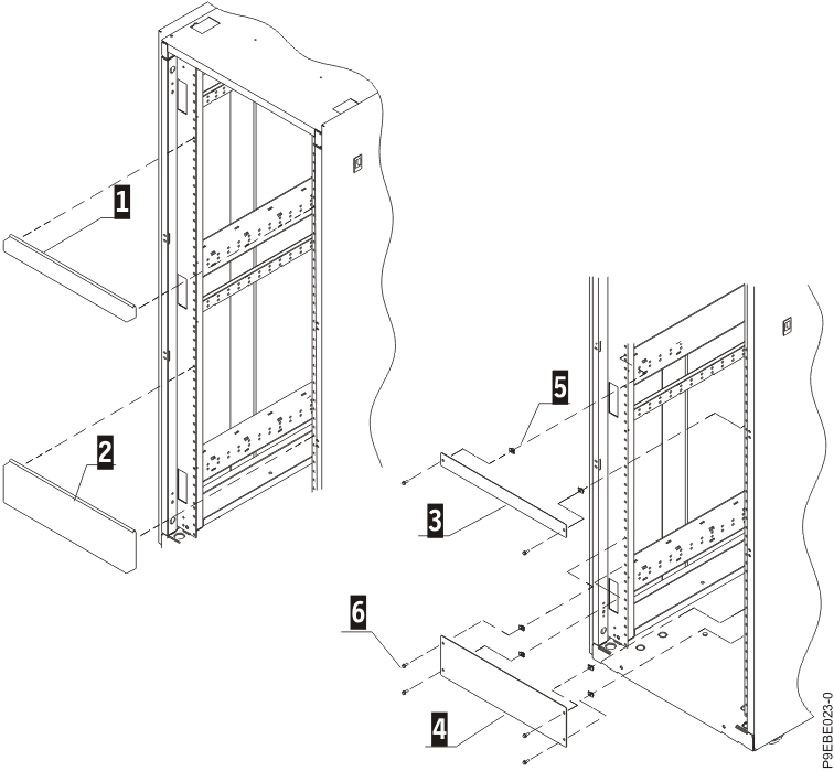

Recirculation of hot air exiting the back of the rack into the front of the rack must be eliminated. There are two actions that can be taken to prevent air recirculation. First, filler or blanking panels must fill all unoccupied rack space that is not occupied by equipment shipped in rack. 1U and 3U filler panels are used to block air recirculation within the rack. If you do not have filler panels installed in your rack, these are available from IBM.
External components, such as a stand-alone USB DVD drive, can be placed outside of the system rack, either on an open design shelf or on an open design cart nearby. An open design means that the cart or shelf does not have any solid sides, which can impact the overall airflow near the external component, the system rack, or both.
| Index number | FRU part number | Units per assembly | Description |
| 1 | 97H9754 | As needed | 1U Filler snap (black) |
| 62X3443 | As needed | 1U Filler snap (white) | |
| 2 | 97H9755 | As needed | 3U Filler snap (black) |
| 62X3444 | As needed | 3U Filler snap (white) | |
| 3 | 12J4072 | As needed | 1U Filler snap (black) |
| 4 | 12J4073 | As needed | 3U Filler snap (black) |
| 5 | 74F1823 | 2 per Item 3 | M5 Nut clip |
| 74F1823 | 4 per Item 4 | M5 Nut clip | |
| 6 | 1624779 | 2 per Item 3 | M5 X 14 Hex flange |
| 1624779 | 4 per Item 4 | M5 X 14 Hex flange |

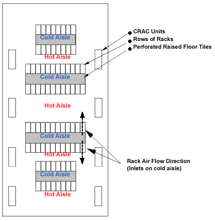

The hot-aisle, cold-aisle arrangement that is explained in the ASHRAE publication, "Thermal Guidelines for Data Processing Environments", dated January, 2004, should be used. In the following figure, racks within the data center are arranged such that there are cold aisles and hot aisles. The cold aisle consists of perforated floor tiles separating two rows of racks. The chilled air from the perforated floor tiles is exhausted from the tiles and is drawn into the fronts of the racks. The inlets of each rack (front of each rack) face the cold aisle. This arrangement allows the hot air exhausting the rear of the racks to return to the CRAC units; thus, minimizing hot exhaust air from the rack circulating back into the inlets of the racks. CRAC units are placed at the end of the hot aisles to facilitate the return of the hot air to the CRAC unit and maximize static pressure to the cold aisle.
The key to heat load management of the data center is to provide inlet air temperatures to the rack that meet the manufacturer's specifications. Because the chilled air exhausting from the perforated tiles in the cold aisle may not satisfy the total chilled airflow required by the rack, additional flow will be drawn from other areas of the raised floor and may not be chilled. See the following figure. In many cases, the airflow drawn into the top of the rack, after the bottom of the rack has been satisfied, will be a mixture of hot air from the rear of the system and air from other areas. For those racks that are at the ends of a row, the hot airflow that exhausts from the rear of the rack and migrate to the front around the sides of the rack. These flow patterns have been observed in actual data centers and in flow modeling.

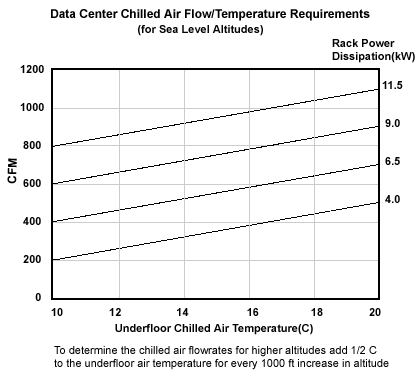

For a data center that may not have the best chilled-air-flow distribution, the following figure gives guidance in providing adequate chilled airflow given a specific heat load. The chart takes into account worst-case locations in a data center and are the requirements to meet the maximum temperature specifications required by most IBM high-end equipment. Altitude corrections are noted on the bottom portion of the chart.

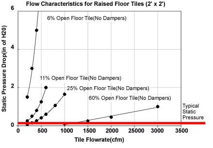

The volumetric flow capabilities of floor tiles with various percent-open ratings are shown in the following figure.
Floor tiles in typical data centers deliver between 100 and 300 cfm. By optimizing the flow utilizing some of the guidelines set forth in this document, it may be possible to realize flows as high as 500 cfm. Flow rates as high as 700-800 cfm per tile are possible with tiles with the highest percent-open rating. Floor tiles must be aligned in the cold aisles with the intake locations on the equipment.
