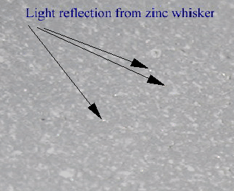

The following figure shows light reflection from zinc whiskers.
Figure 1. Light reflection from zinc whiskers
