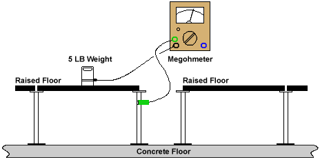

Measuring floor resistance
The following equipment is required for measuring floor resistance:
- A test instrument similar to an AEMC-1000 megohmmeter is required for measuring floor conductivity.
The following figure shows the typical test connection to measure floor conductivity.
Figure 1. Typical test
