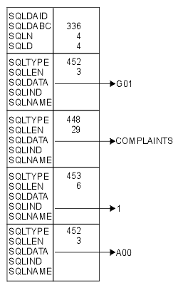

EXEC SQL EXECUTE STMT_NAME USING DESCRIPTOR :INSERT_DA END-EXEC.Assume that the following statement is to be prepared:
INSERT INTO DEPARTMENT VALUES(?, ?, ?, ?)To insert department number G01 named COMPLAINTS, which has no manager and reports to department A00, the structure INSERT_DA should have the following values before executing the EXECUTE statement.
