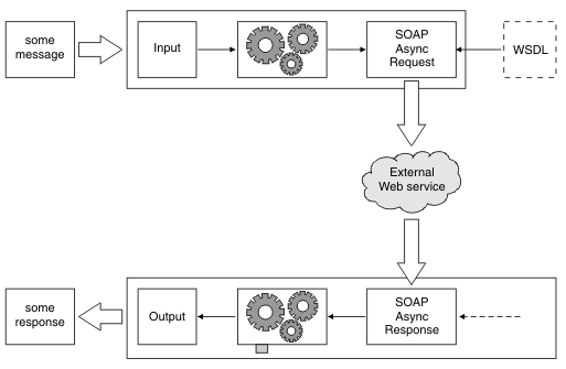

The SOAPAsyncRequest node can use HTTP or JMS transport. It is linked as a pair with a SOAPAsyncResponse node by using a unique identifier, and optionally WS-Addressing, to correlate response messages with the original request. The SOAPAsyncRequest and SOAPAsyncResponse nodes cannot be used with one-way operations.
The SOAPAsyncRequest node sends a web service request, but the node does not wait for the associated web service response to be received. This asynchronous functionality enables multiple outbound requests to be made almost in parallel because the outbound request is not blocked while it waits for the response. The web service response is received by the SOAPAsyncResponse node, which can be in a separate message flow. The nodes are used as a pair, and correlate responses against the original requests.
- Using WS-Addressing to direct the response to the paired SOAPAsyncResponse node. The SOAPAsyncRequest node waits for the HTTP 202 acknowledgment before continuing with the message flow, and the SOAPAsyncRequest node blocks processing if the acknowledgment is not received. A new HTTP connection is made by the back-end server to reply to the SOAPAsyncResponse node. This is the default behavior.
- Using HTTP asynchronous request-response. When the SOAPAsyncRequest property Use HTTP asynchronous request-response is

The SOAPAsyncRequest node is the first half of the asynchronous request and response node pair. The SOAPAsyncRequest node calls a remote SOAP-based web service. The request is sent by the SOAPAsyncRequest node, but the SOAPAsyncRequest node does not receive the response. The response is received by a SOAPAsyncResponse node that is running on a different thread. The SOAPAsyncResponse node is typically at the beginning of a different message flow; however, it must be in the same integration server as the SOAPAsyncRequest node.
The SOAPAsyncRequest node is WSDL-driven, in a similar manner to the SOAPRequest node.
The SOAPAsyncRequest node is contained in the Web Services drawer of the palette, and is represented in the IBM® Integration Toolkit by the following icon:
Using this node in a message flow
A SOAPAsyncRequest node is linked as a pair with a SOAPAsyncResponse by using a unique identifier to correlate request and response messages.
